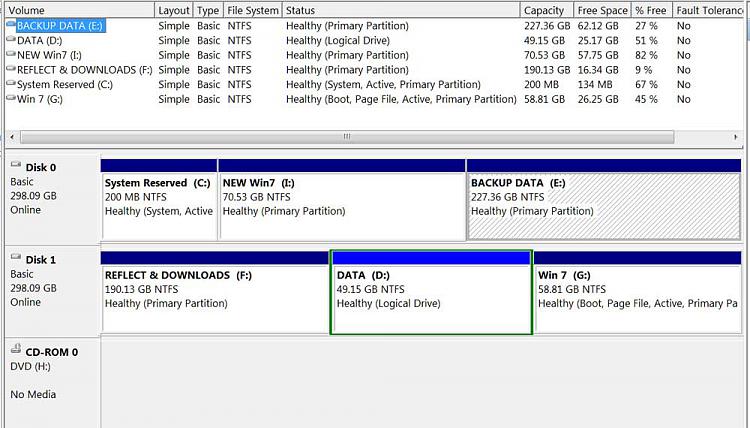

    Well guys, you will see from the attached screengrab that the mission has been accomplished! That is entirely down to you two giving me the step-by-step idiots guide. Thanks SO much for that!

  7. Posts : 22,814
    W 7 64-bit Ultimate
       #27
    Hello Adrian.
    Before you go any further, there seems to be some issues with the new install; will you please boot to the "new" windows 7 and post a snip of that disk management for us to see, that last snip is from the 'old' Windows 7 and things look out of order; thanks.

    Hi Ted, I have no idea how you could tell that screengrab was taken from my old Win 7 partition - but it was!
    Another one attached now, taken after booting from C: New Win 7.
    Cheers
    Adrian
    Attached Thumbnails Attached Thumbnails Win 7 plus Win 7 on 2 partitions?-partition-map-c.gif
  9. Posts : 22,814
    W 7 64-bit Ultimate
       #29
    Hello Adrian.
    The flag "Boot" shows the OS you are booted into at the time.
    There was just some discussion about an incorrect subject that this snip puts to rest, thank you.
