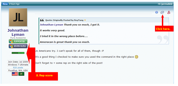

Sorry gentlemen, thaere are two things i dont understand
you can't speak for all of them?? what is this mean? means you like me, dont speak very good english?
+ some rep on the right side of the post! what is this mean?
thank you gentlemen!
My System SpecsSystem Spec
08 May 2011   #8
theog
ME/XP/Vista/Win7
JL Rep score

To say "I can't speak for all of them" means that I can't vouch for the greatness of ALL Americans. I can vouch for myself, and the people I know, but that leaves roughly 311 million more people I do not.
