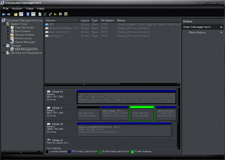

    So do I just bring up an elevated command prompt and write "diskpart" and then do I have to type in the other commands you have outlined?
    Just as I have them listed in the second snip of diskpart.
    johnwillyums said:
    Snip of the command prompt or disk management or both?
    Just disk management.

    ok. Here goes:)

    You're a magic man Ted. Think that worked.
    Attached Thumbnails Attached Thumbnails W7/Linux Mint dual boot upgade-comman7.png

    Good job John, that will make life easier in future for you, well done mate.
    Just to explain, the Active flag is what tells Windows where the "System" boot files are to be created if ever there's a need to do startup repairs to repair/recreate Windows boot files.
    I have seen issues with Windows 7 'confusing' the HDD order in Windows disk management before, that makes me think the old Linux may still be there but not able to boot for some reason, unfortunately I have almost no experience with Linux to be a help getting it booting again.
    If there's nothing on the Linux install you need to get to, it may be worth just installing the new Linux you've been wanting to install.
    If you do so, disconnect the Windows 7 HDD for the Linux install so the 2 OSs don't interlock with the same boot manager and then you could use the F12 one-time boot menu to select which OS/HDD to boot at PC startup.
