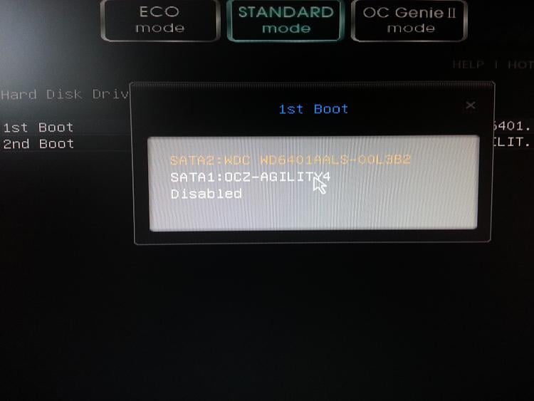

Once I restart, and get into BIOS setup, here's what I see:
As you can see, on the "Boot Option Priorities", the SSD is not on the list. I then go to "Hard Disk Drive BBS Priorities" and the SSD is listed as "2nd Boot".
I change SSD to "1st Boot".
But once I shut down again, everything is reset, and I get the black screen "reboot and select proper boot device or insert boot media" again.

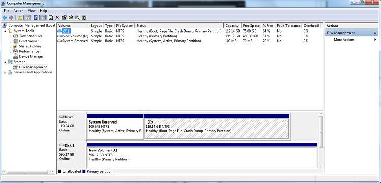

What's weird is that if I get the black screen, but press "Ctrl + alt + del", it works. I look at my computer management, and the last picture is what I see.

To be honest, I don't know what the HDD had. I assumed my friend did a clean wipe off of it so it would be as good as new when he sold it to me. Does this picture help?

It shows you have not extended partitions, but from what I understand, it should not matter with a Legacy(MBR) install.
I suppose the only logical thing to do is to try another hard drive to see if it is better and to check the one you have. But it seems the UEFI firmware is not identifying, or is not able to identify, your SSD with the second drive attached.. Using Diskpart to clean the drive, just in case, might be another option.
Maybe someone else will have another opinion.
The Disk Management looks normal.

The screenshot shows USB HD as first boot device, not HD. Set SSD as First HD, save and exit. Then set HD first to boot, save changes and exit.
If the SSD boots when the HD is not plugged in then it may be boot code interfering from the HD. Move the data off to wipe it with Diskpart Clean Command from the installer then repartition in Disk Mgmt.
