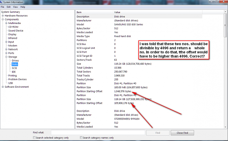

I was told that the Partition properties are wrong, due to going from HDD to SSD. Pic enclosed

At first glance, that pic looks OK. What "properties" were you told looked wrong? The alignment is OK I think.

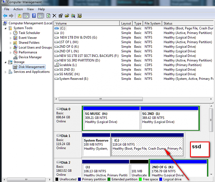

Post a pic of Windows Disk Management.
I assume you are now operating from a restored Acronis image and that pic represents that installation?

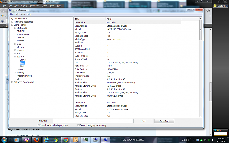

The pics are enclosed.
I was told that by doing an image restore from my good install on HDD was giving me partition problems due to the number returned.
This is what I was told :Look for your SSD and check the partition starting
offset.
It needs to be divisible by 4096 (ie return a whole
number when you divide by this) otherwise the
alignment is not correct.

Regarding the partitions: my understanding is that those numbers you point out should be evenly divisible by 4. Both are. Both are also evenly divisible by 4096, but I am not sure that divisibility by 4096 matters.
