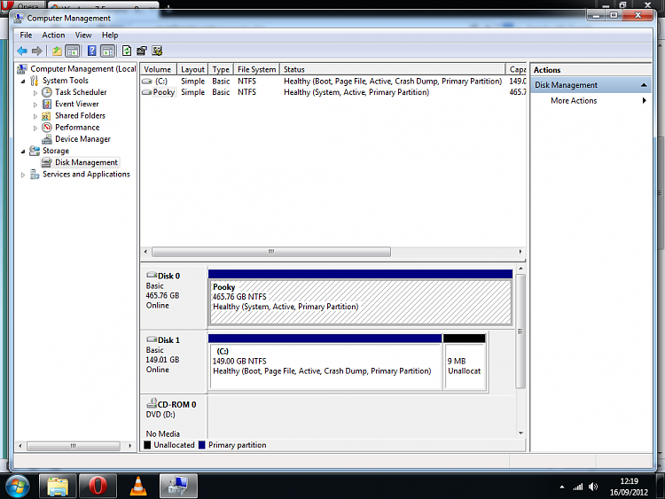

Hey Magus, I took a look at the disk management and found no partitions on the disk. I acquired this from a broken lappy a little while ago and formatted the whole disk to a primary partition. See the screen dump I uploaded.
Anything else I can try?

I'll have to admit to being confused now, I don't know how your system is booting at all considering there is no bootmgr partition on either drive :S
What does startup repair say when you run it?
Your screen shot shows that that other drive, the one you want to remove, is actually the drive that holds the System Reserve partition and without it the system won't boot.
So you will need to do a Repair install once you remove that other drive and maybe do it 3 times.
Check the tutorials for instructions.

Win7 is booting off of DISK0 in screenshot as signfied by the System Active labels.
To move them to Disk1 power down to unplug Disk0, swap its cable to Win7 HD or set it first to boot in BIOS setup, boot into Win7 installer or System Repair Disk to run Startup Repair - Run 3 Separate Times (This is not the same as a Repair Install).
You can then plug back in the other HD to wipe it using Diskpart Clean Command, repartition it as desired in Disk Mgmt, or at a minimum mark Inactive so it won't interfere in the future. Partition - Mark as Inactive - Windows 7 Forums
Keep Win7 HD set first HD to boot in BIOS setup.
