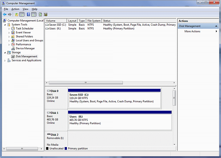

    The Active flag on two partitions could cause a reboot loop or the system constantly asking for which OS to boot to. I think it's possible the OS could write to the other active partition and you'd have system files spread across two drives. This is mine, I have my Users folder purposely on a 2nd drive to save my SSD space, but it's not active.

    Yes, it's fine now.
    Because it was marked Active, the C drive successfully received the System boot files when the repairs were run, since you'd unplugged the other HD so it couldn't interfere. It then continued to boot from C when you plugged back in the other HD because it remained set first to boot in BIOS.
    By deactivating E it no longer can interfere whether you delete bootmgr or not. If it did interfere then what works is to move the data off to wipe the HD boot code with Diskpart Clean Command, before repartitioning as a Logical data drive which can not be marked Active and therefore can never interfere or have the boot files derailed to it. Partition / Extended : Logical Drives - Windows 7 Forums
    An incorrectly-marked Active partition can derail the System boot files to itself when repairs or reinstall are run. Only the OS partition or it's boot partition should be marked Active. If you multi-boot OS's on different HD's via the BIOS, then each HD might have its own System Active partition to make it independently bootable.
