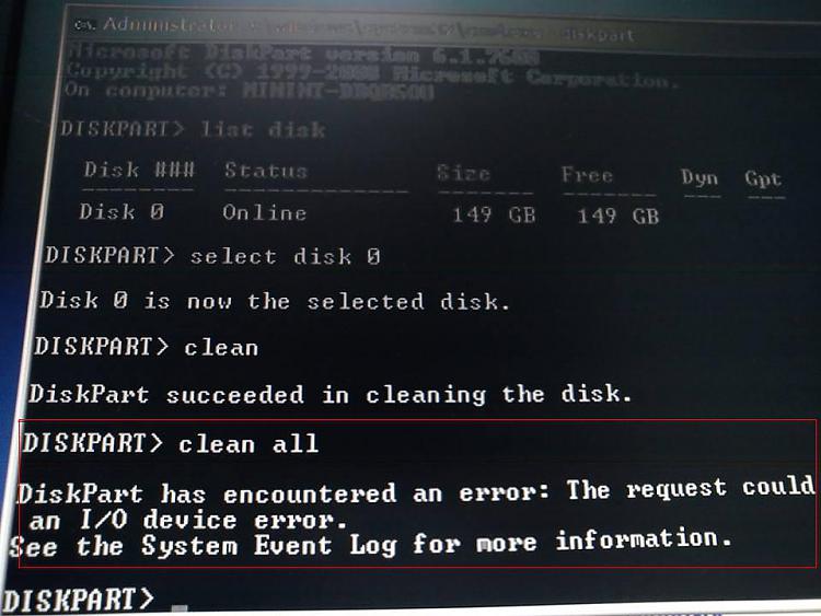

    Could you guys please teach me how to fix the problem ? I've tried the " Clean and Clean All with
    Diskpart Command '' method but it didn't work at ' clean all ' ( Refer to the pic shown below ) . Error:0x8007045d during the creation of partition-111.jpg

  2.    #2
    The error code means the HD is likely failing. I would back up the data on it now.
    Reboot into the PC and tap the F12 key to run Dell Diagnostics full test if you haven't: Dell Diagnostics Utility - How to Run the
    If it confirms the error then you can also run the HD maker's HD Diagnostic extended CD scan to confirm this and possibly make repairs. But I would not trust the drive again if either of the tests say its failing.

  6. Posts : 1,007
    Winndows 7 32 bit
       #6
    Error:0x8007045d during the creation of partition-222.jpg
    After diagnostic done , this poped out .
    Error:0x8007045d during the creation of partition-1377325_10201394868866764_1189546138_n.jpg
    Hi UserOfDell,
    This diagnostic results means harddrive has failed and you need to get it replaced on the system to resolve this issue.
    If the system is under warranty then please contact me through a private message and provide me your service tag and contact information so I may access your system records.
    And, if the system is out of warranty then you contact our Expired Warranty Support at the link below:
    http://dell.to/12LmNBq
    If you have any further queries please feel free to contact us.
