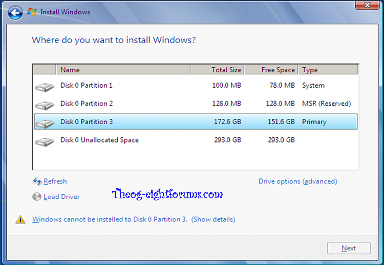

    theog said:
    Partition the Hard Drive in a Windows 7 Install
    Screenshot are in Legacy mode.
    Take a look at Step 9, set partition size.
    You would than have Unallocated Space for DATA Partition.
    Trying to install win7x64 on UEFI, without removing other partitions-windows-8-downgrade-012-sb.png
