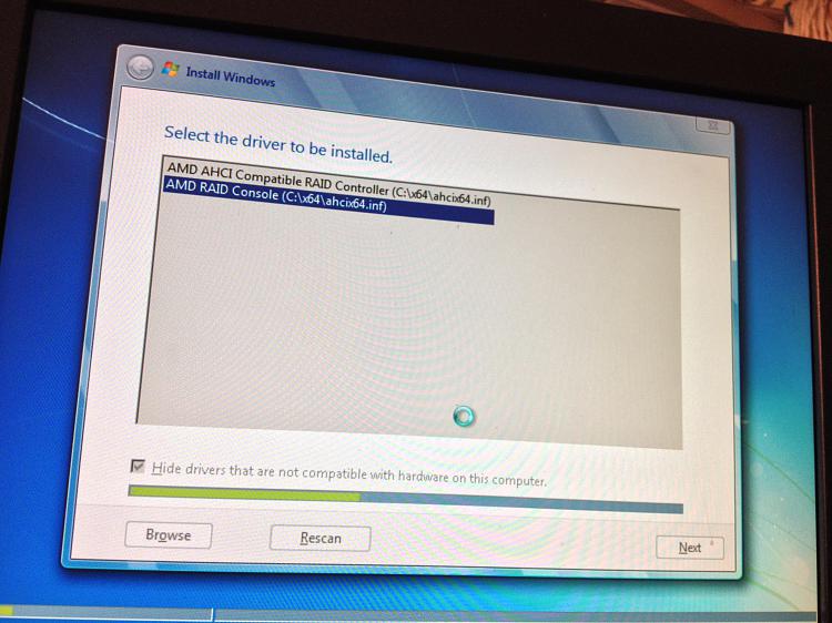

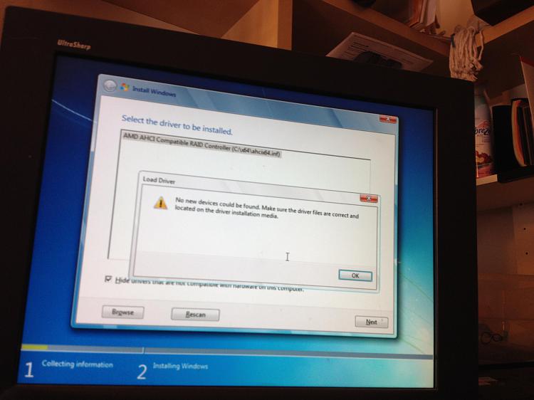

    Hello The plan is to have 2 SSD in Raid 1 Mirror so if one SSD drive then i have second one but this plan is not working as my motherboard is UEFI and it is pain in my back when ever it comes to install OS.
    Here is screenshots :

  5.    #5
    No, if you lose one HD in a RAID1 then you lose everything. There is no redundancy. There is also no appreciable performance benefit vs. installing on one SSD without RAID.
    So I would disconnect the RAID, set your SATA controller to AHCI, install to one HD with the other unplugged. If it prompts for driver then you have a bad installer. Start over with a new ISO burned to DVD with the tool from Steps 1 and 2 of Clean Reinstall - Factory OEM Windows 7
    For UEFI follow these special steps: UEFI (Unified Extensible Firmware Interface) - Install Windows 7 with - Windows 7 Forums
