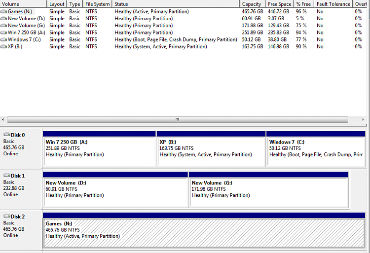

    Ok, here is the screen shot.
    The main thing is that I have 4 OS ( 3 win 7 ) and 1 XP.The other partitions do not have any operating systems on them,they are just for games,pictures,music etc etc.

  10.    #30
    Why do you need 3 Win7's? That is excessive. Better to have one perfect install.
    XP is booting all OS's. If you ever want to remove it it will require Marking Win7 Partition Active to run Startup Repair - Run 3 Separate Times with all other drives unplugged. When Win7 partition starts and holds the System flag, you can delete XP partition and recover the space using Disk Mgmt Partition or Volume - Extend , or How to extend partition easily with Partition Wizard - video help. Then install EasyBCD to 7 to add the other OS's.
    Games N: partition should not be marked Active as only the System partition should be marked Active: Partition - Mark as Inactive - Windows 7 Forums
