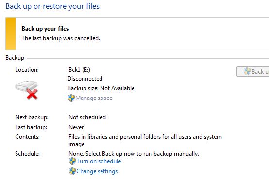

    Oh boy! Another issue has surfaced. Well, two, actually. I seem to be unable to resize the E: partition up too 24 GB from its current roughly 22GB. AND, (there is always and AND) when I went to look at the windows 7 backup tool I found this:
    Arrrrgh!
    I am using EaseUS as a partition tool.

  6.    #16
    What's in the backup? Files, image? It's safest to store your image on external. So I'd move the files off of the logical data partition, delete its volume and then Logical partition in Disk Mgmt.
    Next download and burn to CD with Windows Image Burner free Partition wizard, boot disk to Resize C, drag the left border of C to the left against SysReserved partition, then resize the right border to make fully adequate space for your onboard storage needs. I use mine to house the User folders so that the C image is smaller and absent files outdated after image is taken. How to Move/Resize Partition with partition manager? Partition Wizard Move/Resize Partition Video Help.
    As David was saying the factory install of Win7 is not desirable and most tech enthusiasts won't run it. Better to follow his link to do a perfect install then preserve it externally with a Win7 or Macrium image so you never need to reinstall again. Everything we've learned about what works best for Win7 is also in included so you can go from the worst install to the very best possible in a few hours of attentive work.

    There is nothing in the backup. This is a brand new (Second hand) computer. I just wanted to make a back up partition but it all went tits up somehow. Doh!
    When I try and delete the volume I am left with unallocated space I seem to be able to do next to nothing with. Um, what's a "logical partition"?
    When I first tried to backup the drive before anything else was written on it I ran out of space over and over again with all the CD's CD-RWs and DVD-RWs I have. So I tried to make a backup space on the drive and made it too small. I then found that I could not resize it and it was on the wrong side of C: (See uploaded image on page 1). I tried again after renaming the partition from Bkup1 to Backup. Win 7 refuses to accept the new name and tells me it is "disconnected" and changing it back does not work either. The hole got deeper. Stopped digging and came here.
    Now, if I can try your patience and get you to walk me thorough this nightmare and back to sanity, though I promise not to fall in love with you and/or stalk you, I would be grateful. Just assume you are talking to a complete idiot with ADHD.

    Oookaaaay! The free partition wizard is listed as
    MiniTool® Partition Wizard Bootable CD
    I tried that last night. As I said before in this thread, I booted it up and found myself in a dreaded Dos screen. I ran the thing and it took an age to work through the drive so I left it over night. This morning it had produced an unintelligible list of stuff full of numbers I could not work out along with options that made no sense. I gave up.
    Did I use the wrong software? I searched Google and it sent me here: Partition Wizard Bootable CD allows user to manage partition directly with partition manager bootable CD. Which seems to be the page you also listed. Trust me, there was no "dragging" option available in whatever it was I downloaded and burned to CD. (I feel another Homer moment coming on)
    I am downloading a copy of the Win 7 ISO at the moment. 1h 28 mins to go.
    Any advice on the refusal of backup to recognise the new partition (See pic above)?
    Oh, I am reading up on logical partitions as we speak (TYPE)
    Right, this guy has shown me I am trapped in "old school" thinking about partitions. Yay! I learned something new. Almost http://helpdeskgeek.com/windows-xp-t...cal-partition/
    OK. E:backup is now a logical partition. I deleted its volume and then the logical partition as you requested. I now have unallocated space left behind.
    Off to re-burn the software you suggested in case I screwed up...back later
    And thanks again I appreciate the time and effort.
