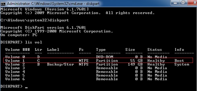

    There is nothing wrong with my hardware, I did not pre-format the partition. I installed like a clean install. I set my mobo to defaults in UEFI changed the SATA controller from IDE to AHCI and booted the Windows DVD. Installed it to the unreserved SSD nothing special.
    Attached Thumbnails Attached Thumbnails Windows 7 and UEFI BIOS Boot Manager error 0xc000000e-untitled2.png   Windows 7 and UEFI BIOS Boot Manager error 0xc000000e-untitled.jpg

    It placed the System boot files on the 149gb Backup/Storage partition, as you can see in the DIskpart screenshot showing all Volumes. The Boot label on C only means it is the presently-booted partition.
    This is why it didn't issue a System Reserved partition during install to a blank HD, because you had not unplugged all other drives so it will place the System boot files on the first available Primary partition.
    To remedy this, Mark Win7 Partition Active then power down to unplug all other drives, swap the cable for drive labeled Disk0 in Disk Mgmt to Win7 drive, boot into Win7 installation media System Recovery Options to run Startup Repair - Run 3 Separate Times until Win7 boots and holds the System flag.
    When you plug back in the other drives make sure Win7 drive remains set first hard drive to boot in BIOS setup, then mark the Storage partition Inactive: Partition - Mark as Inactive - Windows 7 Forums.
