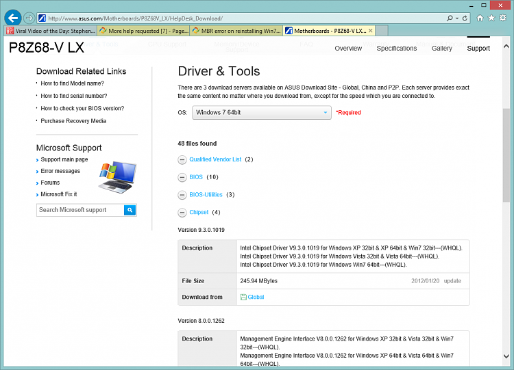

    What driver are you looking for? The chipset...SMbus.
    They're easy to find if you look in the right place. Based this on your system specs mobo
    Motherboards - P8Z68-V LX - ASUS
    But please ONLY install missing or flagged devices.
    Don't think "Hey.... that's shiny and newer.... I'll get that one too" :)
    ONLY the ones that are not installed or are flagged in DevMgr.
