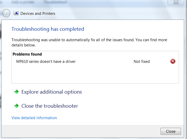

    The scanner in my Canon MP610 multifunction printer suddenly stopped working, giving an error message along the lines that it could not find the driver. To try and fix the problem I uninstalled the printer completely and now I can't re-install it at all. I have tried installing it from CD and on line following the instructions on the Canon support page to the letter, all to no avail.
    After uninstalling all the Canon components, Devices and Printers shows an Inkjet Multifunction Printer that I cannot remove - see Attachment 1. If I then try and install the printer from CD with the printer off and disconnected everything appears to proceed satisfactorily but when I plug in the printer and turn it on it is not recognised. Right clicking on Inkjet Multifunction Printer in Devices and Printers, then Troubleshoot reports that the driver for the MP610 device is not installed and clicking on Apply this fix reports further unidentified problems. See Attachments 2 and 3.
    I have tried doing this from a user login and administrator login, connected to the internet and not connected, all with the same result. The one difference is that when logged in as administrator I don't see the Inkjet Multifunction Printer in Devices and printers.

    When I try to install using the latest drivers from Canon support the system doesn't recognize the printer when I plug it in and turn it on. If I install from CD it also fails to recognise the printer but it also gives a choice to select the port manually. When I do the MP610 Printer device appears but no matter which port I select the printer still does not print. I can remove the MP610 Printer device but I can't remove the Inkjet Multifunction Printer device no matter what I try. Do you know what it is?

    I can remove the MP610 Printer device with printui but not the XPS Writer, which I tried just in case. The print spooler is empty. Inkjet Multifunction Printer doesn't appear at all with printui.
    What exactly is the Inkjet Multifunction Printer anyway? I installed the printer again with the bare bones OS just to check, and it does not appear there under Devices and Printers. Just the MP610 Printer. Which all makes me think it's the problem.
