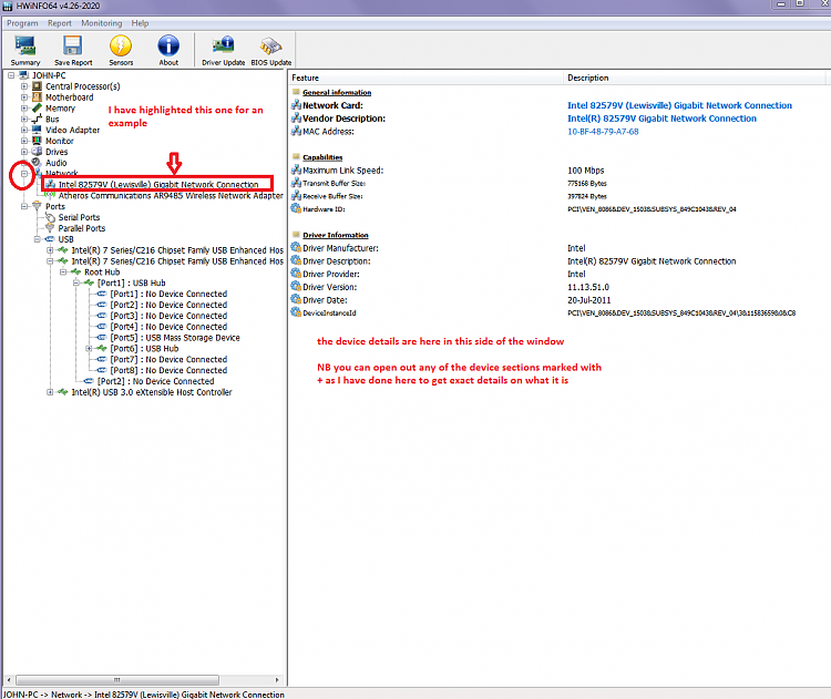

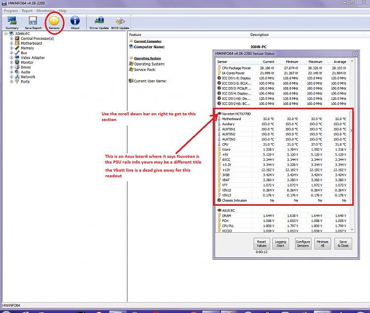

    Now if you want some really detailed info on your machine give this a run when you need in depth stuff especially when it comes to who the manufacturer is and model numbers etc I'll attach pics for an example .
    Using HW Info
    PART A:
    You can test the volts on the PSU with HW Info HWiNFO, HWiNFO32/64 - Download < download the right bit version and close the right hand window select Sensors and scroll down to the power section where you will see what the volts are doing see my pic. In my pic the section (Nuvoton) with VBATT is a dead give away you are in the section for the rail voltages. There are other section titles and one that pops up often is ITE
    Now the voltage on the different rails have to be within 5% =+/- of what is required or the machine will not work properly if at all.
    IE
    12v = 11.4v min to 12.6max
    5v = 4.75v min 5.25v max
    3.3v = 3.135v min to 3.465v max
    See this for the rail voltage info
    PSUs 101: A Detailed Look Into Power Supplies (Section 2.)
    The original right hand window shows the machine running and is handy for that but for looking at the components in some detail close it and use the main left hand side panel
    FOR OTHER COMPONENTS
    PART B:
    Open each small square with + in it on the section the components are in and then click on the individual component/s (it will highlight in blue) - in the right hand side will appear all sorts of details including brands speeds and other essential info that particular device. See pics for example.
    Attached Thumbnails Attached Thumbnails USB Code 10 error on Macrium cloned SSD EVO 840 to EVO 850-hw-info-devices.png   USB Code 10 error on Macrium cloned SSD EVO 840 to EVO 850-hw-info-desktop-psu.png   USB Code 10 error on Macrium cloned SSD EVO 840 to EVO 850-hw-info-network.png
