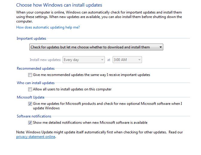

    Don`t set your updates to automatic, set it like this. You should be checking what every update is, after you install the 1st 200 that is

    Hi...updates all completed successfully. All 173 of them. I've changed the update settings as you've suggested but your Win Version gives you other options that I don't have. Are you operating 10?
    Now remember I'm a novice. How in the world can I hope to know what I'm looking at with any update and its' relevance to me and this computer? I've gone to MS for more detailed info on some of these in the past and it was very discouraging.
    Thanks for all the help!
    Doc
  7. Posts : 13,576
       #57
    No I`m not running 10. 10`s update page looks nothing like 7`s
    If you want to know what an update is for, you simply high lite it, then on the right side of the page you`ll see the 2 words More Info, you simply click on that and it will take you to the Microsoft page that explains what the update is for.

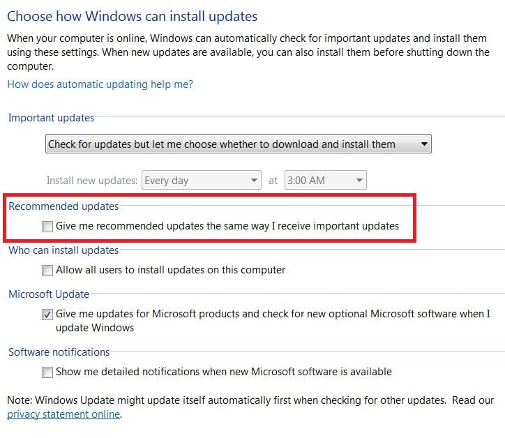

    I believe the update settings are fine as is,
    Win-10 free upgrade offer is over
    We would usually uncheck Give me recommended updates the same way as Important updates
    You have the red outlined box checked
    Once 11-2-2016 actually gets here it won't matter anymore besides KB3172605 was reissued in September so as long as it doesn't fail to install along with any other updates everything should be fine :)
