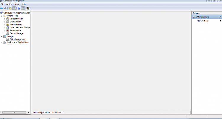

Well, I would post a screen shot, but every other time I open up disk management it hangs on "Connecting to virtual disk service" and doesn't bring up any of my drive info. I'll post the screen shot of that.

I've now restarted 3 times and the disk management tool just keeps hanging whenever I try to load the information. I don't know what to do. W7 has so many bugs. On my previous install it thought I had a non-genuine version because I changed the partition size. That bug forced me to do this installation, and now i'm having a completely different problem. I don't get it.

For the disk management, are you waiting long enough for things to appear? Sometimes it can take a bit more time. You could try going directly to it by pressing the start orb and writing "diskmgmt.msc" without the quotes then pressing enter.

I've been waiting 45 minutes and it still hasn't come up. Sometimes, after a restart, it opens after about 15 seconds. So I know there is something wrong.
