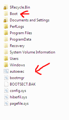

1) You need to copy your Boot files from Disk0 to Disk1.
2) Than remove XP Disk0 & replace with Win 7 Disk1.
3) Than do a Startup Repair 3 to 4 times.
Startup Repair
My System SpecsSystem Spec
