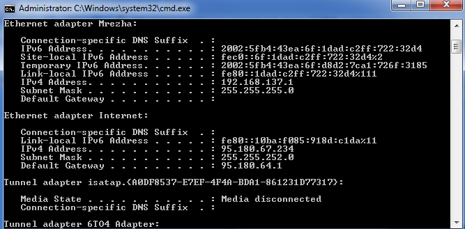

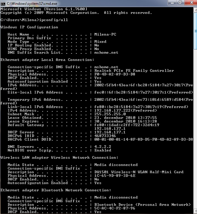

Can you take a screen shot of your network configurations using cmd and utitlity ipconfig/all on your HOSTpc.
If possible take a screen shot of the same thing from your laptop, take the image on a flash drive, upload to HOSTpc and post here.

I uploaded here u can see,host SS is ipconfig.jpg,other SS is from client laptop.
I can see that my host pc is acting liitle strange...i think this ipconfig wasnt before that laptop..im confused ..:/

Can you post your HOSTpc config again, some info is missing from the top.
Such as IPconfig and Ethernet adapter LAN config.
your client one is fine.
