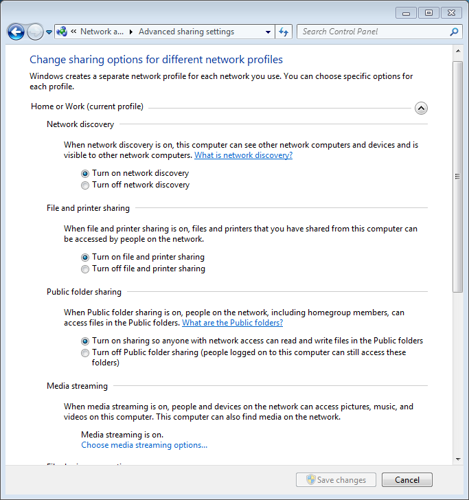

On the computer that is having issues, do you have everything configured in Network and Sharing Center > Advanced sharing settings as I have shown?

I do have it exactly like that.

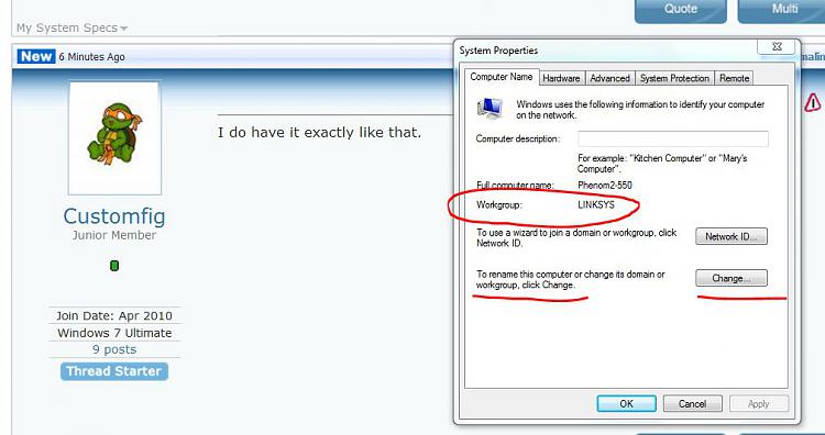

Are they all on the same workgroup (name) ?

Yes we are all on the same workgroup.
