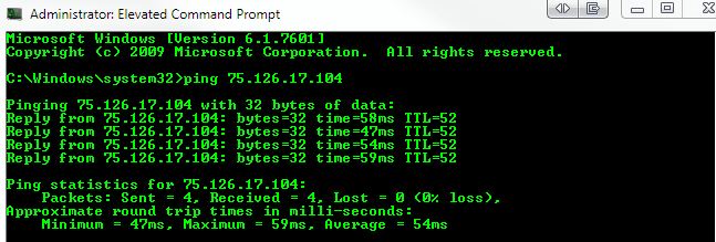

Just for reference - Time Warner/SoCal here also, and I can't connect to that address either.
Ping looks fine though, so does tracert. Can't access though.
