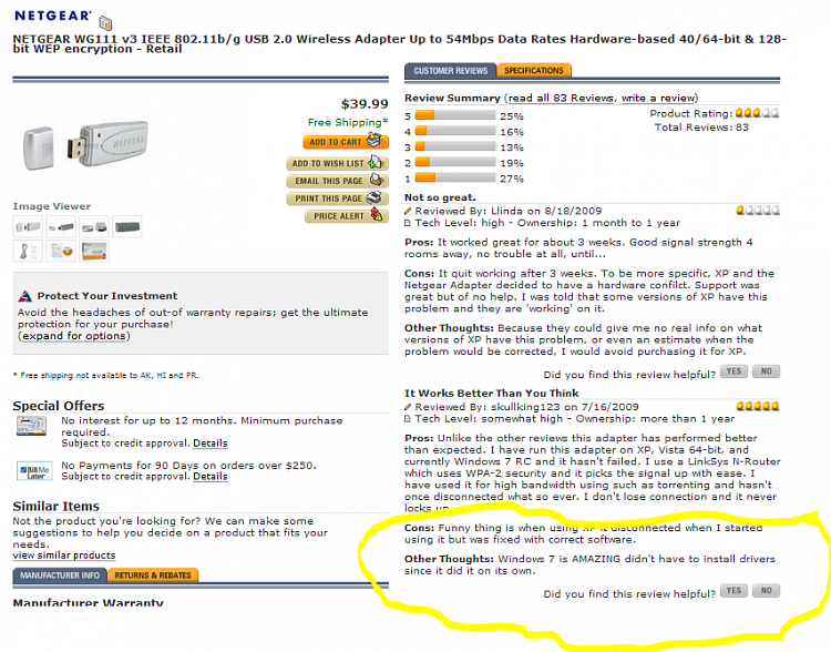

    This may sound like a silly question, but have you tried this?
    1. make a wired network connection,
    2. stick the WG111 it in an usb port (don't run any driver installation)
    3. wait until the new device is found, and (not) recognized,
    4. then right click it in device manager, go to driver tab and let windows look for the driver online?
    I ask this because I've seen a review comment from someone praising Win7 for installing the driver automatically.
