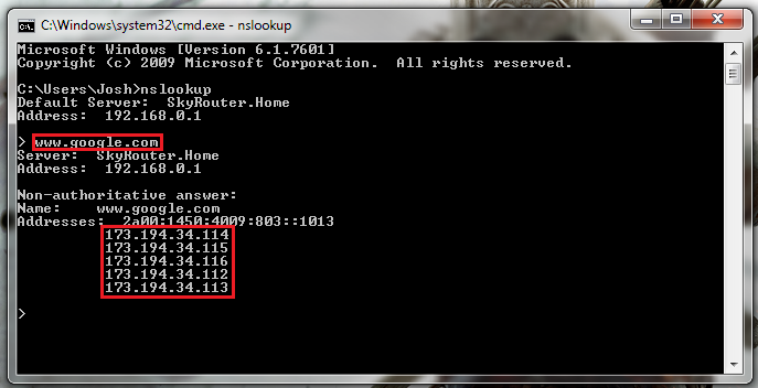

    Nope, it's the other way around You put www.google.com into your browser and the computer will use DNS to find it's IP address so you can be routed to the appropriate server that holds Google.
    Does sevenforums have any network specialists. like internetworking?-dns-lookup.png
    On a DNS server there is simply a hostname with an IP address next to it. Think of it like a phone book, when you wish to phone someone say 'Bob' your phone doesn't dial bob but rather look at it's phonebook for bobs number to dial. DNS is the same process with domain names (name) and IP addresses (number).
    This is what it looks like on the DNS server side:
    Does sevenforums have any network specialists. like internetworking?-dns-lookup-2-.png
    When a device goes to this server asking 'What is the ip address of 'Home-Laptop'?' the server will respond back - 192.168.1.50
    Hopefully this helps,
