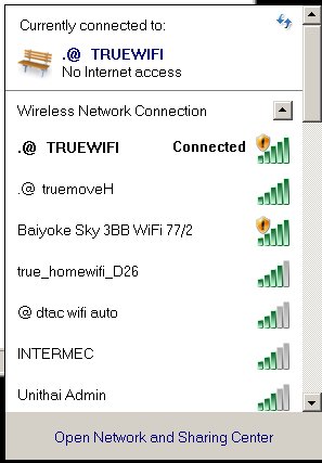

When I follow the steps mentioned by dsperber, the window that pops up for me shows a lists of WAPs that are in range. It is the same window that I get if I click on the network icon in the notification area by the clock. Here is a image of that window published by a university. Is that the window that you see? Is that the window that never populates with a list of WAPs that are in range? Is that the window that shows that you are connected to the hotspot and also tells you that you have "No Internet access"? Or are you using a 3rd party app to control these connections?

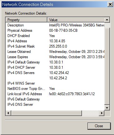

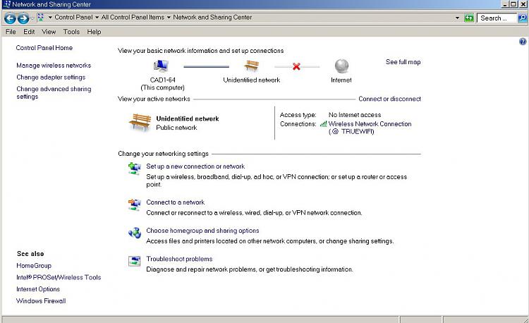

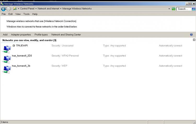

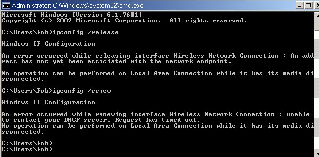

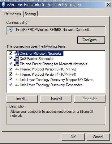

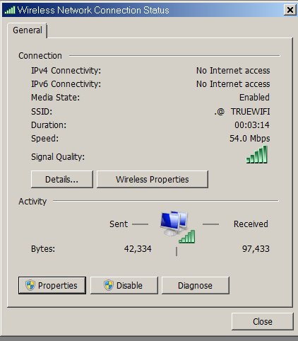

Been back to my local hotspot and once again, no luck. I can connect to other networks that are available, but as I don't have passwords for them I can't check if there is any access. (even the wap's that are "unsecured" still ask for a password. My home network is still working fine. I have 2 wifi modems at home, both connect and have no problem accessing the internet. After having tried every combination of everything I could think of, I am out of ideas now, so I have done some more screencaps of the various setup windows in the hope someone can see a problem.
Also, I did a new ipconfig /all for the windows 7 system that doesn't work, and also another one from my XP boot drive that does work. And I did a screencap of a manual ipconfig /release and ipconfig /renew so you can see the error messages. The network I am trying to connect to at the hotspot is called @ TRUEWIFI, a very large wifi provider here in Thailand. The other 2 you can see on the manage wireless netwoks screen are my 2 home wifi's.
Do you think there maybe some component service that should be running that isn't? I went into admin tools/component services and enabled everything I thought might be ntework related, and that didn't help either, so I am at a loss to understand.
BTW, I am not running any 3rd party software to manage the firewall or anything, but....wait on a minute... I just realized I am running Peerblock, I wonder if that could be confusing things. I'll try to get back to the hotspot tomorrow and try that.
Regards, Rob

Once you connect to one of those other networks, you should have an IP address.
Can you get an IP address from any of these other hotspots?
I'm not sure what the problem is or if something is not running... but it really would help us to know if you can get an IP at a hotspot. It does not matter if you need a password to surf the internet. We only care about getting an IP address from any hotspot.

Problem Solved!! ....and I feel like a bit of an idiot for not realizing what was wrong before. It was Peerblock that was stopping Win 7 from getting an IP address all along. I have peeblock set to run on startup, and its icon was in the hidden part of the systry so I didn't see it blinking. So I set the exceptions it needed to run on this hotspot and everything works perfectly now. As to why I didn't have to do this at home, I have no idea...I certainly can't recall having had to do that before.
Anyways, thanks to all for your help, I certainly have learnt a lot more about setting up wifi access now so all wasn't wasted.
