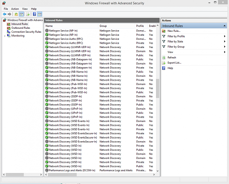

You mean there are no Network Discovery settings listed for inbound and outbound on the Windows firewall? There should be about 30 each way per the picture below shows default inbound rules.
In either event and after reading much about this problem in the past you still need to do run the fix for the base filtering engine as this is still the fix for this particular problem.
In fact many others only had a firewall problem with missing entries and the base filtering engine appeared to be intact, same complaints etc. but the base filtering repair still fixed the problem.
You need to run ServiceRepair.exe, this won't hurt anything if it's not the problem but it's most likely the only fix you will need for this problem.
I receive the message that my ESET installation ended prematurely - ESET Knowledgebase

No Option to enable file sharing in firewall?-firewall-rules-network-discovery.png
