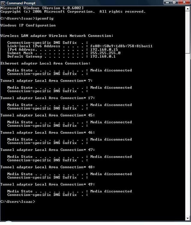

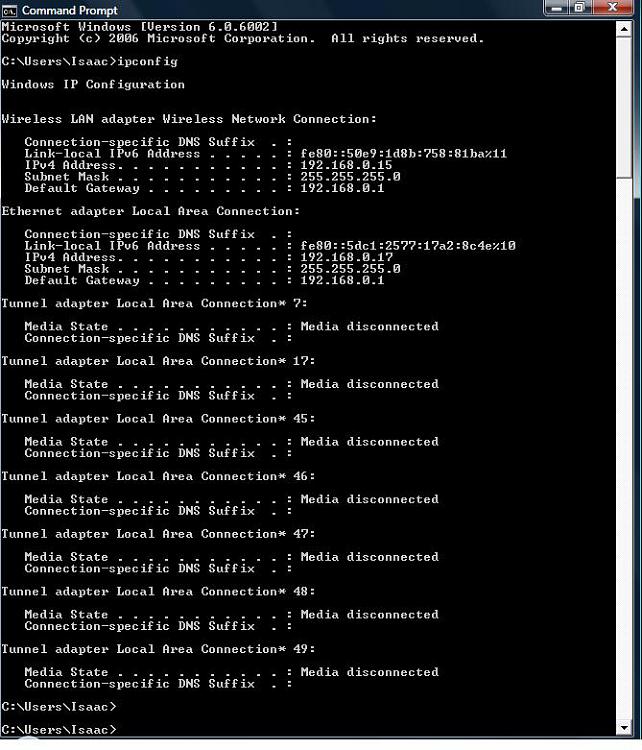

Attached is a screen capture of my ipconfig when I am not connected by the ethernet cable, as well as my ipconfig when I am connected (second screen capture). Any help is greatly appreciated.

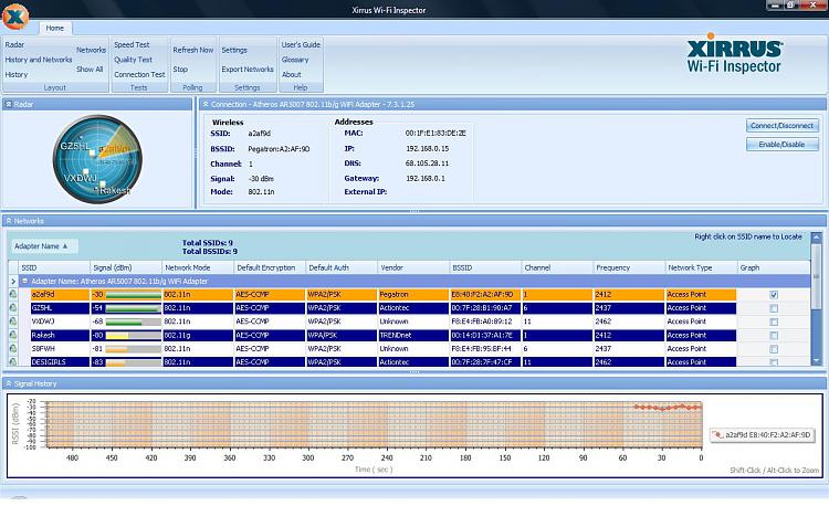

Edit: Attached is my Xirrus log as well. I hope I am doing this all correctly. Thank you everyone in advance.

Ok, you have the tunnel adaptor problem which is nothing new.
To get rid of all those extra adaptors which is the cause of the connection problem you will need to run the file below which should delete all those extra adaptors.
There is a 32 and 64 bit version, you need to extract the file you need for your system "32 or 64 bit" and run the file then reboot.
It may require a reboot and a couple of tries to get rid of them all. Post the ipconfig/all again after you do that.
You will definitely want to update the firmware on this new router so as to make it compatible with your lap top which should prevent the problem from occurring again.

Hi again, well.... I did as you instructed and unfortunately, it did not remedy the issue. I ran the tunnel adapter removal file as you instructed, did the windows update, then restarted the computer and it still won't connect to the wireless without the ethernet cable some reason. I know I am in great hands, so I am not stressing. Attached is the log after all was said and done.

This shows that the extra tunnel adaptors are gone and you are showing a valid IP for both the wired and the wireless connection which is interesting considering your complaint about the wireless not working. Just remember to unplug the wired connection in order to test the wireless because Windows will typically choose the wired connection by default.
The extra tunnel adaptors must have been left over from the repeated attempts to connect to the modem/router although I'm not seeing any real problem with this connection, and from Xirrus I can see you are connected with a strong signal.

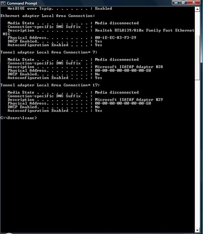

I'll do as you advised now. I have indeed tried to connect by disconnecting the ethernet cable and without the cable, the status on the wireless remains "Unidentified" (screen capture attached).

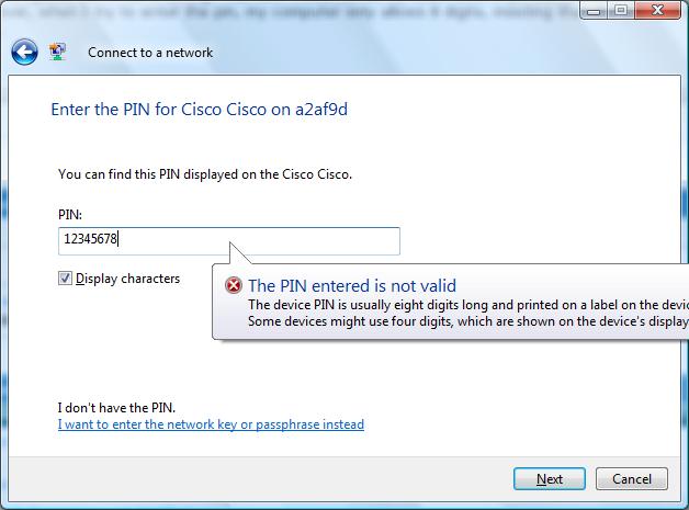

I think I may have figured out what is wrong. This new router/model by Cisco uses a pin instead of a security key. The pin is 9 digits. However, when I try to enter the pin, my computer only allows 8 digits, insisting that the pin can only be 8 characters long.
Do you know how I can bypass this and enter the full 9 digits??? I don't understand why my computer is insisting the pin is only 8 digits when it is actually 9?
