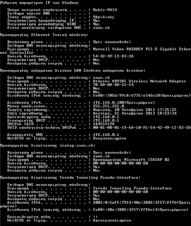

    The last week i have connection issues like not being able to use my browser cause theres not internet connection while my skype is normally working.. So when when i run troubleshooting the result is that the dns does not respond.
    As i read somewhere i should run the ipconfig/all and so did i.
    The point is that i dont know what to do now so can somebody help me?

    In your case the DNS server is pointing back to the router so you might want to check the DNS settings in the router's set up page and make sure they are valid DNS servers or try using Google's DNS at 8.8.8.8 and 8.8.4.4
    Skype works because it doesn't use DNS.
