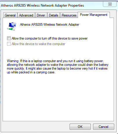

    You may try to disable the Power Management mode of your Wi-Fi adapter from Device Manager, see attached image.
    If that didn't help, I'd download your Wi-Fi's latest driver from the Manufacturer's site.
