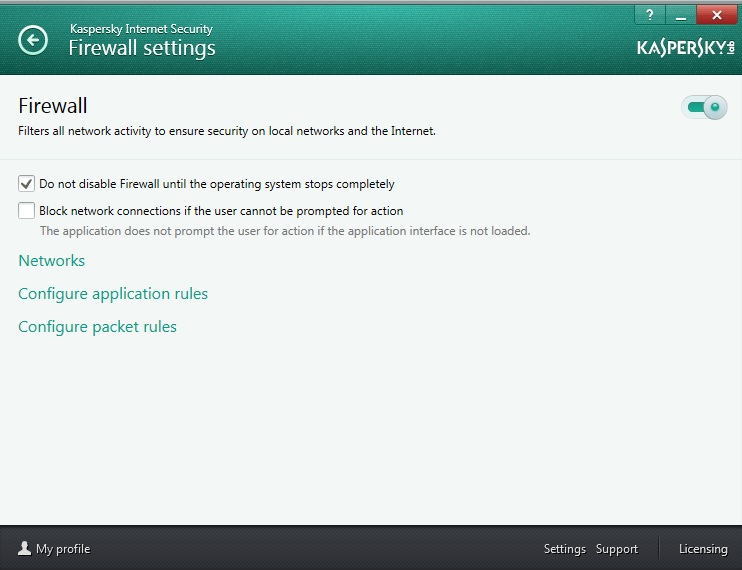

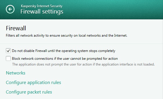

    I installed a Netgear ProSafe Firewall FVS 328, and set up a different network on the LAN side, (10.0.0.x subnet on LAN. WAN is 192.168.16.x network). All worked well with regards to internet access. With regards to sharing folders we have come up against a problem. On machine B, we can see under 'network' both computers and after setting up a homegroup we can see and access all files that are required on machine. However, on machine A we still cannot see either machine under network in windows explorer. Under 'Homegroup' on the same page we can see Machine B but when we click on it we can see no folders in the pane where you would expect to see the homegroup folders. Both machines have Kaspersky internet security 2014 on and after making sure the LAN was a trusted network, I disabled the Kaspersky firewall just to take that out of the equation. We found on both machines that the windows firewall was enabled so we have disabled that with still no improvement. We have checked that the homegroup sharing options are identical on both machines, but still no improvement. When we have run the homegroup troubleshooter it seems to indicate that there is a network problem but is unable to specify what it is. Both machines can access the web so I don't think it is a bad cable.

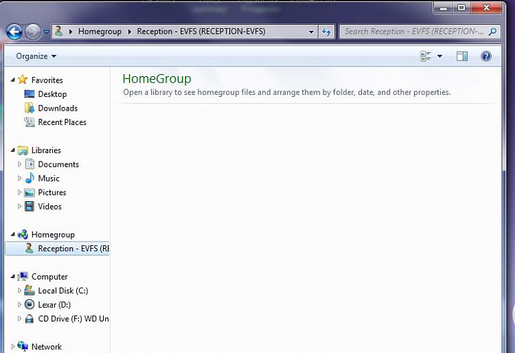

    Once again in machine A neither machine shows up under the network icon in windows explorer, but machine B shows under the homegroup icon. However no folders are available when that icon is clicked on. In network and sharing centre when you ask for a full map machine B shows up but when you double click it won't open up any further.

    Win 7 home premium workgroup sharing issue-machine-b-visible-through-homegroup.jpg

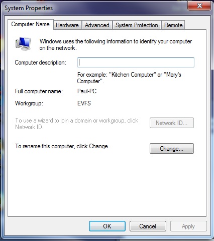

    • What is the Workgroup that both machines are connected to? EVFS as shown here:

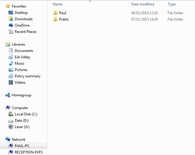

    Was able to access the files on Machine A from machine B by double clicking on Machine A (Paul-PC) icon under network:
    Win 7 home premium workgroup sharing issue-access-folders-machine-through-network-icon-mach-b.jpg
    Homegroup access was not possible though:

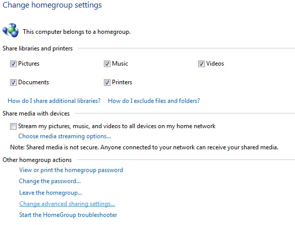

  9. Posts : 7
    Windows 7 Home premium 64 bit
    Thread Starter
       #9
    Well I changed the Hosts file on both machines and I'm afraid it made no difference. I am going to post some screen dumps off both machines.
    Firstly Machine A (Paul-PC)
    Win 7 home premium workgroup sharing issue-machine-kaspersky-firewall-settings-1.jpg
    Win 7 home premium workgroup sharing issue-machine-kaspersky-firewall-settings-2.jpg
    Win 7 home premium workgroup sharing issue-machine-advance-homegroup-settings.jpg
    hosts Machine A.txt

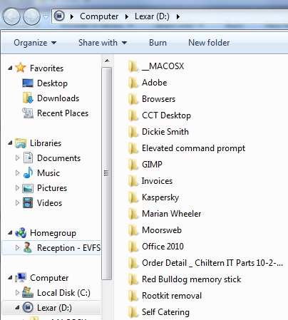

    Now Machine B (Reception EVFS)
    hosts Machine B.txt
    Win 7 home premium workgroup sharing issue-machine-b-adv-homegroup-settings-1.jpg
    Win 7 home premium workgroup sharing issue-machine-b-adv-homegroup-settings-2.jpg
    Win 7 home premium workgroup sharing issue-machine-b-homegroup-settings-1.jpg
    Win 7 home premium workgroup sharing issue-machine-b-kaspersky-firewall-settings-1.jpg
    Win 7 home premium workgroup sharing issue-machine-b-kaspersky-firewall-settings-2.jpg
    Any ideas here on how to resolve this would be good. We are either thinking of doing a backup, re-install, and restore on Paul-PC (Machine A) or buy a new one, (Machine A is not a new machine, but Machine B is). Any other ideas would be welcome.
    Regards,
    Cctster
