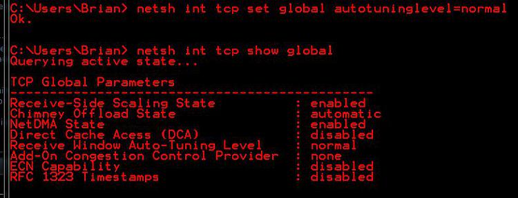

    And after the commands.
    Does it look right ?
    Attached Thumbnails Attached Thumbnails An Update on Windows TCP AutoTuningLevel-capture1.jpg

    I believe this is all that is needed to enter
    netsh interface tcp set heuristics disabled
    If you want it more like win-8 & 10 which is shown on the right and 7 on the left here you can use Callender's link to speednet or what ever it was on page 1
