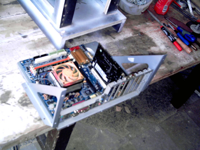

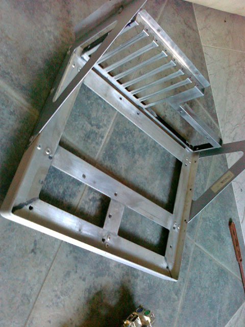

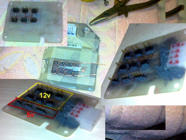

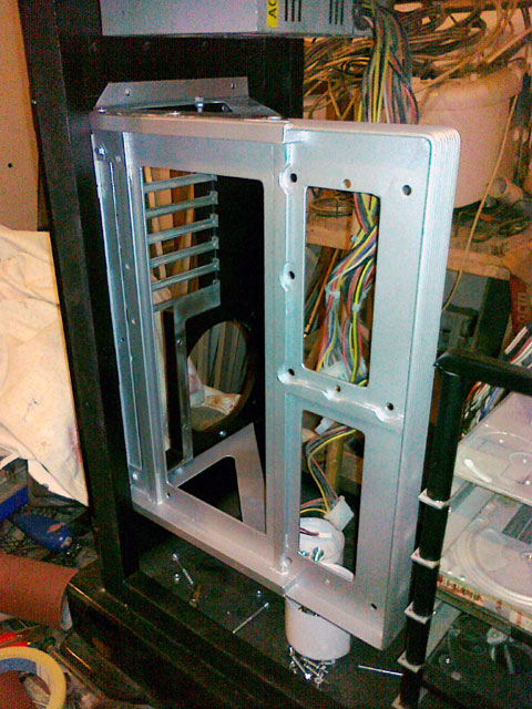

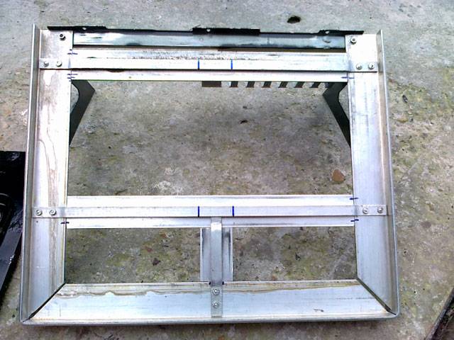

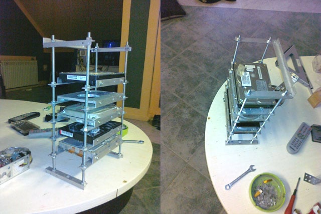

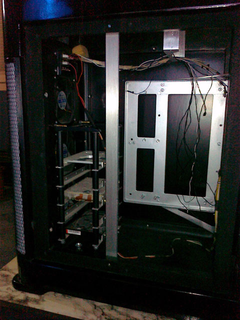

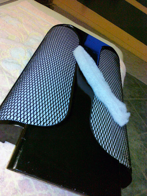

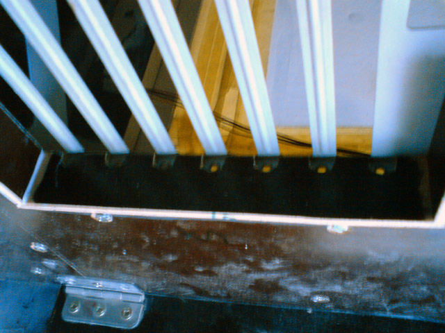

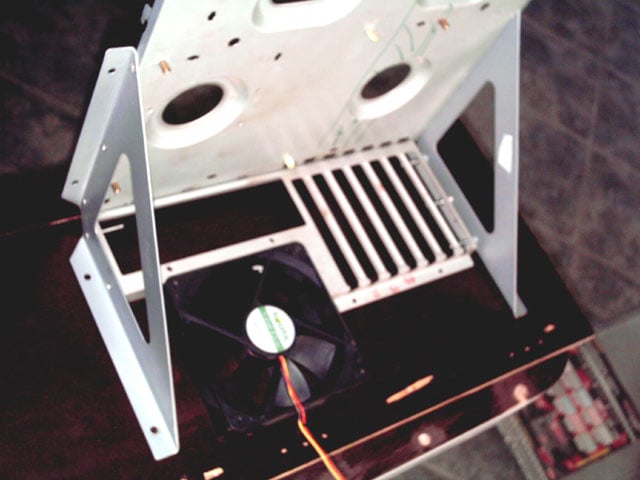

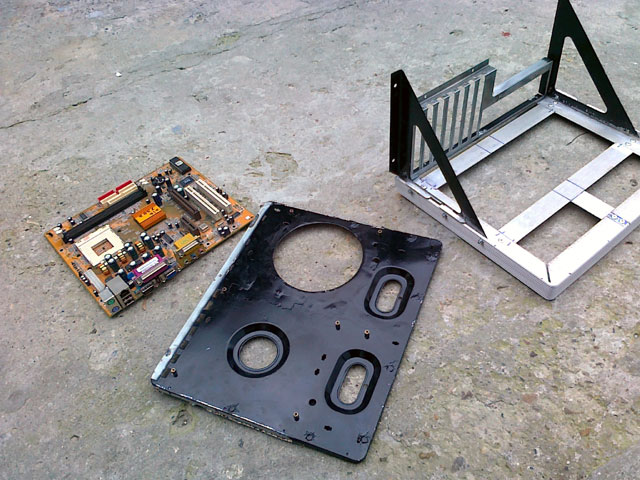

    Here are some of solutions /replacement on my project if it helps.
    pic 1-5 motherboard plate & back pannel
    pic 6 - fan connector plate
    pic 7-8 hdd ( 8 black in between hdd's is rubber pipe screws only on top/bottom)
    pic 9-13 new stronger motherboard plate
    pic 14 filter
    pic 15 finished empty case
    Just make sure every component is grounded with each other.
    Attached Thumbnails Attached Thumbnails Project: The Ultimate Computer Desk-0-kuciste-039.jpg   Project: The Ultimate Computer Desk-0-kuciste-038.jpg   Project: The Ultimate Computer Desk-0-kuciste-055.jpg   Project: The Ultimate Computer Desk-0-kuciste-143.jpg   Project: The Ultimate Computer Desk-0-kuciste-144.jpg
    pic 14 filter
    Thanks for the pics, gave me some good ideas. I plan on running exposed copper wiring around the inside of the cabinets where the components are - it'll be decorative (I will try to make it look like circuit boards on the inside) but it will also join all the components together and eventually to an external ground.
