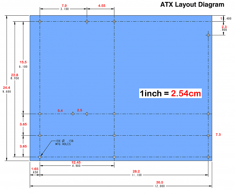

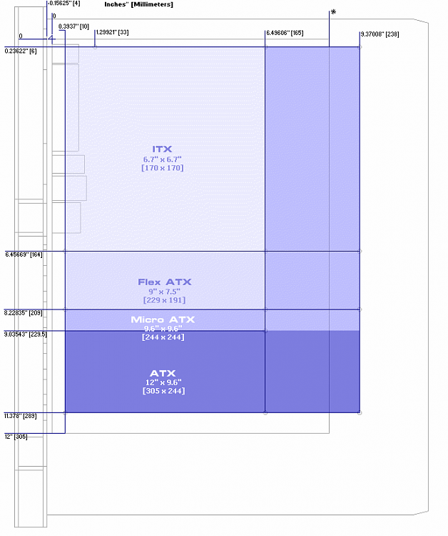

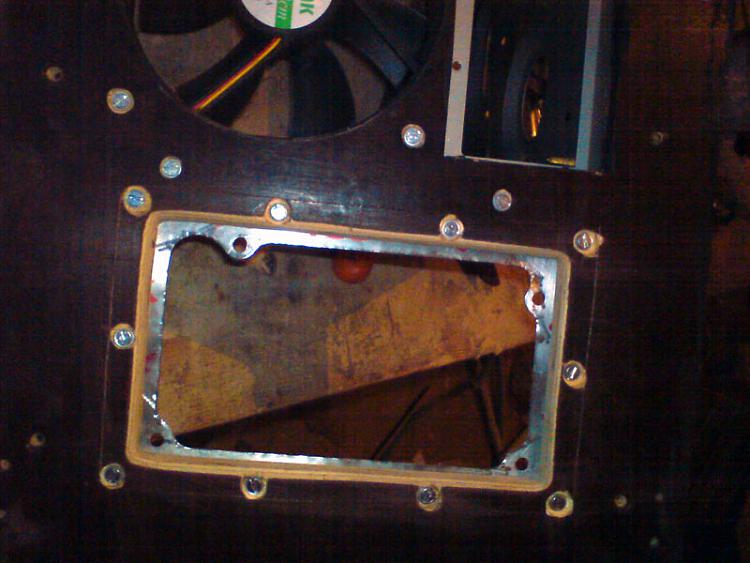

    The most difficult part for me was motherboard tray and I/O parts
    but one at the time
    You can cut from some metal sheet for PSU easiest part
    I/O & PCI card used from old case (but it can be re manufactured)
    Motherboard tray was made from scratch with a loot of blueprints /photoshop
    and old mini atx and atx board so it can be reused if I put another mboard in without need of new holes.
