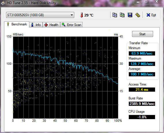

    The HD Tune benchmark results are confusing for me.
    Seagate 1 TB internal on a SATA 2 port:
    Segate 1 TB external on eSATA 3 port (Marvell 91xx):
    The identical drives had been purchased at the same time; the internal drive has about 4% usage while the external does 38%. Yes, I did rerun the tests and had the same results.
    Why would there be such a wide gap in access time and burst, even if they are connected to different SATA ports?

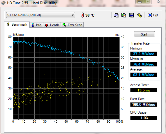

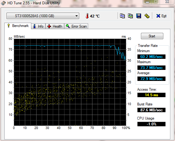

    Just for curiosity, I've tested my older machine (specs in my profile).
    Internal Seagate 320 GBs on SATA 2 port, the drive is four years old:
    And this is the external Seagate 1 TB (different model# from the above) on eSATA 2 port, the drive is about 7 month old:
    I am puzzled... the four years old drive has better access time than the 2-7 month old?
  2. Posts : 7,878
       #92
    The thing with benchmarks is that they are not always consistent.
    For example, run HDTune 10 times in a row. Your numbers won't be the same...but they really should be.
    When I build my current machine, 2 years ago, I went with a 1TB Seagate 7200.12. It performed great, but benchmarks it had about 25ms access time for some reason. No matter what port, what cable, what drives, or what OS.... (vista or 7), I showed this same slow access time. Real world usage didn't seem to indicate anything was wrong. It was this very problem that brought me to this forum.
    In the end, I ended up buying a WD Caviar Black 1TB for my new machine, and it was about 15Mb/s slower transfer, but was around 8-10ms access time. I put the Seagate 7200.12 in my older Linux desktop, and it came back with 12ms access times and has performed just fine.
    Benchmarks for me, are not the be-all end all for my performance. They are simply an indicator showing that nothing is terribly wrong or broken.
    If you put that same 2-7 month old hard drive in 5 different boxes, you would likely get 5-7 different results. Don't fret over 1-2ms, it's simply just not worth it.
    Maybe I should've listen and leave the machine alone, but no...
    I moved the internal drive to the Marvell based SATA 3 port and might as well, changed the cable:
    Other than the huge increase in burst rate, which is doubtful at best, there's no change in the benchmark performance. Or for that matter, in the real world usage performance as you've stated.
    1-2ms agreed, but when the difference is about 6ms that does indicate some issues; however, the difference is still not to the point to be worth for looking into it further. Especially when the drive works just fine otherwise.
    The issue could still be the benchmarking tools and/or the drive quality in itself. I could swap the drive to verify it, but at this point it isn't worth for the effort...
    Yeah, that burst rate is obviously not realistic...clearly the benchmark is not working properly or measuring remotely accurately.
    Exactly, my random access times on my Seagate 7200.12 read in the 20-25ms range on my box. I drove myself nuts and replaced it with a WD Caviar Black. All-in-all, I can tell no performance difference between the drives on the actual machine. That Seagate in another machine is fine. So, I'm unsure if there were any actual issues, but I felt better seeing that my access times were lower with the WD. And just being a storage drive in the end (as I'm now using an SSD for the OS)...the access times are far less important now.
