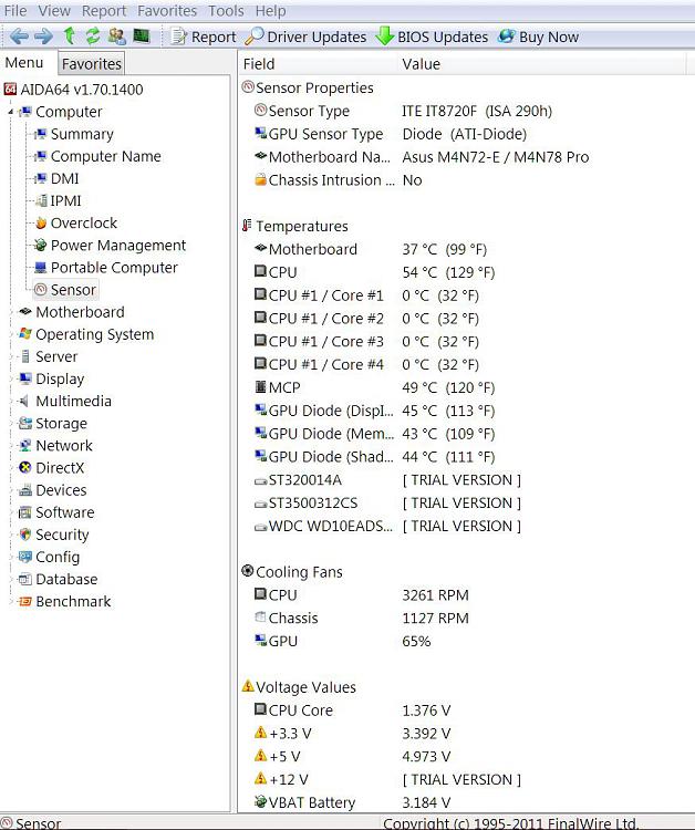

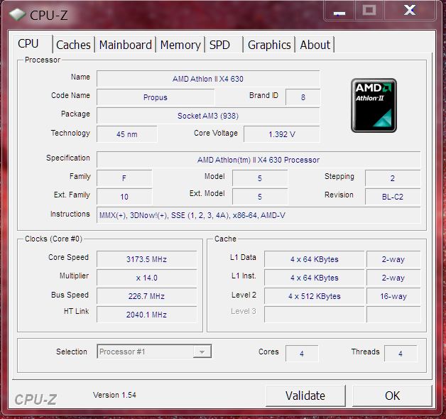

    At 228 x 14 i am effective achieving a 3172mhz processor with temperatures of only 51C which has actually decreased and to boot my RAM timings are now 5-5-15 cause i am not pushing the RAM quite so hard at a frequency level.
    The DRAM timings were left on AUTO too!
    Here should be some results showing this overclock, its the temperature drop that interests me the most! faster but cooler!
    Any way very easy way to add at least 10% to your processor, not pushing any further to leave the CPU to have a longer happier life and to aid system stability, I am happy with the increase and there is a noticeable difference when running CPU heavy games like FSX, the frame rates are about 10% higher!
    Hope this helps someone!
    Attached Thumbnails Attached Thumbnails Finally worked out good overclock!!-aida-64-overclock-page.jpg   Finally worked out good overclock!!-cpuid-overclock.jpg

    couple more aida 64 shots here.....
    FSB is set in BIOS to 330 with the 14x mutiplier, actual FSB is running at 331.7 apparently!
    Attached Thumbnails Attached Thumbnails Finally worked out good overclock!!-aida-core-temp.jpg   Finally worked out good overclock!!-core-clock.jpg
