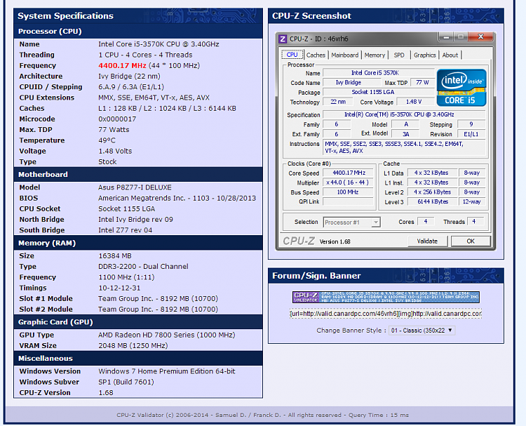

    Running the mini-ITX at 4.4.....snappy

    That seems rather a lot of voltage to me Alan for that speed. I know every chip is different but I would imagine you should be able to drop that to at least 1.3V and be fully stable, maybe lower.
    I don't know how your temps are at 1.48V but they should be considerably lower at 1.3V too.
    Paul.

    Good call I'll drop it down.

    I think there are lots of folks on here with the same CPU as you, hopefully they will chip in with what they run at. I expect you can go lower than 1.3V @ 4.4GHz maybe even down to 1.2V but you will need to have a good play with it to see how low yours will go.

    Maybe some deep fiddling with LLC, Offset, or something. Steve got 5.0 at 1.28, I think it was.

    Down to 1.288v @ 4400

    Alan, my previous chip a 3770K not a 3570K could run 4.3 on stock voltage. If you haven't already, look at this guide
    Ivy Bridge Overclocking Guide ? Asus Motherboards#. It works. it is done on a different board, but almost all Asus Z77 boards have the same overclocking options that work the same way. That is the way Kelly has his bios set up and I do too. So the settings work well for either chip. I would suspect you should be able to run at 1.2-1.25V. My 3570K I used to own could do 4.6 at that voltage using those settings. Just some suggestions. But, at the end of the day it comes down to the piece of silicon Intel sent you.
