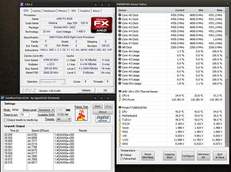

    @Ganjiry, the problem is that the board does not have LLC and has a limited range of vcore, highest is 1.449.
    I can do higher through overclocking software provided by MSI (ClickBios II and Control Center). Will try that option, but to get something like 1.43 under load I would probably have to set it way past 1.5. I'm not sure if I dare...

    That is where i told you APS will kick in you can keep it at 1.43 turn on APS the drop will go down to 1.42-1.41 that is when the APS is on when I turned it off i could only get 4.4 stable at 1.43 anything higher almost needs to be maxed at 1.449 and i think the reason you have that stupid vcore ceiling is because the board supports 125 w socket and when you get a board 140 w socket you have more v core to play with
    That is why i switched boards to a 140 w and i have more v core to play with it took me 2 years to get it even though the board says bios can reach up to 1.80 volts in the manual but the new Bios UFEI killed it lol and pretty much stuck you with the voltage but yet they are great overclockers

    Hi Solar,
    I'm already at 1.512 through click bios II. CPUZ shows 1.48 idle 1.44 IBT.
    Testing 4.7 right now.
    APS is enabled.
    Will let you know how it goes.
    I was eying a Sabertooth today. A good deal too, but the idea of rebuilding once again is a total turnoff.
    More to follow as IBT on 4.7 is done.
    Thanks,
    J

    So here it is: 4.7 stable, 10 passes IBT 1 hour p95.
    Core temp stayed around 50C, socket 55C.
    I only used Click Bios II to up the vcore. It accesses BIOS directly and mods values there and saves them, unlike control center. You have to re-start after any changes for them to take effect.
    Now I'll go back to my stable 4.5, with a slight increase in vcore through click bios, which allows for lower temps and quieter rig.
