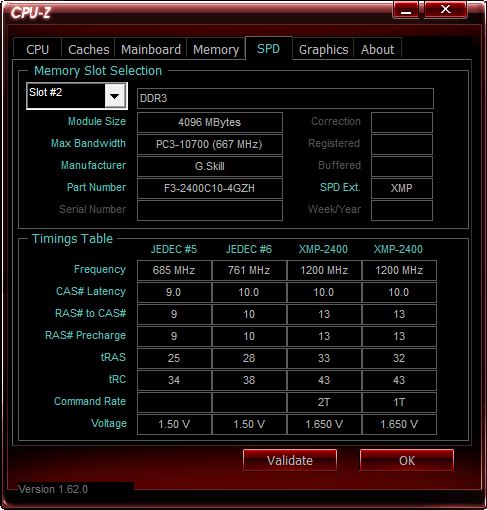

    Dude said:
    Yes I see your point. I was basing my info off JEDEC standards, it's a technicality so to say, my ram runs at 1600. I did not mean to cause confusion, but as my screenshot shows I have 1333 ram overclocked to 1600.
    Dude, your ram is running at 1600. It is 1600 ram. What I think you are looking at are JEDC specs which show the different frequencies the ram is capable of. If you are looking at the SPD tab at the max bandwidth, almost all ram says that. It is only a spec telling your motherbooadr the ram speed and timings to allow it to boot the first time. After you get into bios and set the timings, frequency and voltage, then your ram will run at specs. I have 2400MHz ram. The board is not capable of posting it at 2400MHz without the correct timings and voltage. After giving the board the correct timings and voltage, it will run at specs. True 1333MHz ram is not capable of running at 2400MHz, no matter what timings and voltage you use. If you look, my 2400 MHz sats the same.

    No problem Dude. Gary, Tradesman explained it quite well on G Skill forum, but I can't find his post explaining CPUz and what the max bandwidth really means. It is basically telling the board how to boot it the first time. It is not the max bandwidth of the ram, just the bandwidth for the board to post.

    This thread essenbe?
    Misconceptions from CPU-Z - G.SKILL TECH FORUM

    essenbe said:
    Britton30 said:
    Dude said:
    Yes most Ram is 1333. Even when we buy 1600 or whatever it's actually 1333 by JEDEC standard, the merely add the timings to the profile (xmp) and sell it as 1600.
    Do you have a link to this info? I don't think that is correct.
    It isn't.
    Steve I am not that that bright when it comes to this stuff but that / those standards might be in this somewhere. Standards & Documents Search | JEDEC
    Oops mean tot add my Asus Z77 board I have 2400 sticks in now and the board I think limits that to 2100 max and it did default back to 1333 when I first got it but like I said not too bright on this stuff and I might have been doing something wrong .

    Dude said:
    Man I love a good brain wrinkle!
    Yes, that's it. I think it explains it pretty well.

    ICit2lol said:
    essenbe said:
    It isn't.
    John, I went there and they wanted me to register and in some cases buy some of the articles. needless to say I didn't. But, the article linked by Dude explains it fairly well, I think. All boards have a default memory speed, usually 1333 or 1600. It will not run ram any faster than it's default speed unless you basically overclock it, to the board's perspective. That is what the max bandwidth is for. To tell the board what it can boot at on initial startup or after resetting CMOS. After you get into bios, you can set the frequency, voltage and timings for the ram to run at it's rated speed. It has nothing to do with the max bandwidth of the ram, but to the board. When you set the timings and frequency so your ram will run at a higher frequency cpuz max frequency states it will run at, to the board you have overclocked the ram because it is running faster than the board's default speed. To the ram, it is running stock as that is what frequency it was made to run at.
    But, as I understand it, the physical qualities of the stick of 2133 ram is much different than a stick of 1333 ram. Ram can be overclocked to run higher than it's rated speed, but only to an extent. I don't believe it is possible, no matter what timings and frequency you put in bios for a stick of 1333 ram to run at 2400. All ram is 1333 but the timings are changed to make it run faster is not true. All boards default ram to 1333 is true. Gary and I had the same 2133 ram and the same board once. We both tried to overclock it to 2400, but never came close. We did get it to run faster than 2133 but not even close to 2400. Gary got closer than me, but that is another story. But you have to add in that some boards are not made to run ram faster than a certain speed and the memory controller in the CPU plays a part in that too. I'm no expert on ram, but that is pretty close to the way I understand it. To show you, with your ram set to 2100, run winsat which shows its actual bandwidth. You will see that it is faster than the 'max frequency' stated on cpuz. I hope that made sense. I know what I was trying to say, but I'm not sure I explained it right.
