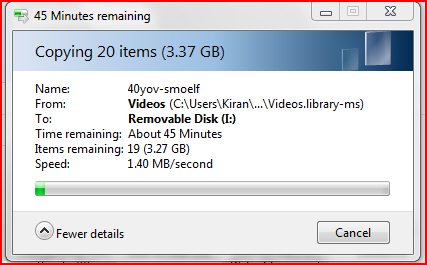

    Help with usb performance
    I m getting very poor performance from my usb ports it used to work fine when i had XP. Some1 plz help.

  3. Posts : 139
    windows 7 Ultimate 32bit
    Thread Starter
       #3
    i checked the bois settings evertythinhs fine there. but the speed is still low
    when i start copying something the speed starts at about 600 kbytes/sec and then gradually increses upto 13-14. but it takes a lotta time for the speed to increase

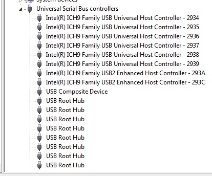

  4.    #4
    Check ur usb controllers... sometimes they also create problems

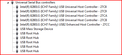

  6. Posts : 139
    Thread Starter
       #6
    i get this problem for a lotta pendrives except for sum and i get this problem with my sisters mem card
    Attached Thumbnails Attached Thumbnails Help with usb performance-usbcon.png
