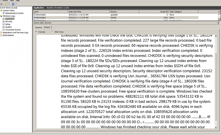

    I did what I said I would do last night as you told me that the 1001 event was a normal start up thing.
    I was told that to do a chkdsk that one had to go to Computer > right click > Properties > Tools > check disk > schedule > close out and then reboot, which I have been doing giving us this wininit thing.
    So I thought about it on the way to work and got home last night and ran chkdsk from Start > chkdsk > Run as admin - a little black screen popped up and the check was over in a very short time indeed.
    So I have obviously been wrongly advised as to how to perform a chkdsk!! Just out of curiousity I ran the chkdsk the same way a short time after and you can see the result in the pics. Plus you can note the time it took for the second wininit one to start up as I did the set up about two minutes after the first chkdsk ended that I accessed from Start.
    There is a little info in the reports that may be of interest but it all looks reasonably ok.
    (This happened on all four machines)
    Look thanks for staying with me on this one I know I am a ruddy nuisance, and I could really give the person a serve for telling me how to do it - but won't because it's not worth the grief.
    You're a real friend - a lot would have dumped me ages ago!!

    No problem, mate!
    It is good, that you have figured that out.
    Btw, when you run chkdsk from Windows (chkdsk-results-x picture), it runs in READ-only mode. So it can't fix anything, just reports. If you want it to fix and move stuff it has to be started before Windows (chkdsk-results-xx.png picture).
