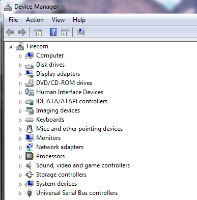

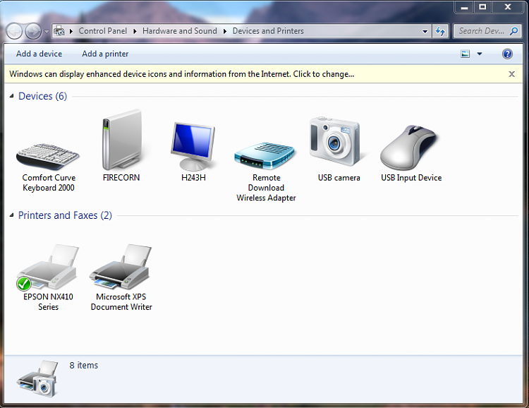

    yea, opening the case may be the only way, but its the big box with wires coming out of it. you say the computer is only slightly slower than normal? don't rule it out, but perhaps it isn't a hardware issue. you've updated everything in windows update and all drivers (device manager and devices and printers don't display any yellow exclaimation points?):
    15 minutes to boot into Windows?-capture.png15 minutes to boot into Windows?-captured.png
