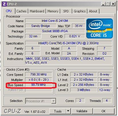

In this forum pc running slow out nowhere in post #5 I downloaded CPU-Z
At post post #7 Mellon Head mentions "bus speed" (I am in the dark at this point.)
My CPU feedback (with CPU-Z)
SPECS:
Toshiba Satellite C665
Am I expecting too much ?
Thank you :)

15 Oct 2013   #7
bawldiggle
XP Pro (x86) | 7 HP (x86) & (x64) | 7 Pro (x64)
Power settings is "Balanced"
With Advanced Power settings as Toshiba settings.
Laptop is mains powered 95% of its life.
High Performance (setting)
  • Core VID: 0.821 v to 1.191 v ... an increase of 45%
  • Core speed: 798.30 MHz to 2894.02 MHz ... an increase of 262%
  • Multiplier: x8 (8-29) to x29.0 (8-29)
  • Bus Speed: unchanged ??
I have set power back to "Balanced" because "High Performance" will suck the battery rather quickly.
I don't trust laptops with their fan underneath to manage heat either.
"High Performance" setting does not improve boot/reboot times ... now at 55 seconds for a reboot.
Looks like I will have to live with these "times"
I would like to know about "Bus Speed" too. (Google !)
Thank you for your help :)

15 Oct 2013   #8
bawldiggle
BUS SPEED
Bus speed is fixed and cannot be tweaked.
What Is System Bus Speed on Intel Processors?
I will just accept what I have.
This learning is a strain on a ducks brain !!
