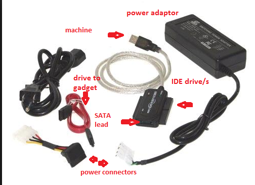

    You can then run that tutorial (second link) I mentioned before and transfer the data back (that you want) form the old drive by using a SATA to USB gadget which you can get reasonably cheap and are always a handy gadget to have. (see pic)
    Seems a fussy way around but you will end up with a bloat free machine with just you stuff on it.
