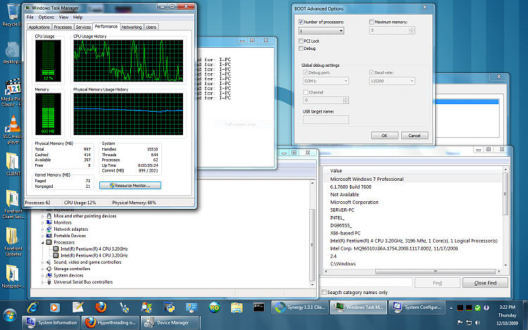

darkassain
Quote   Quote: Originally Posted by Digerati View Post
You do not have two CPUs. You should leave it at 1.
it depends since windows sees a P4 HT as "2" Logical processors but 1 core...
hold on ill test this right now...
edit just tried and yes it does disable the virtual core...
look at the pic
windows recognizes it as HT in the DM but deliberalty only uses one logical processor...

10 Dec 2009   #12
Digerati
Windows 7 Profession 64-bit

10 Dec 2009   #14
darkassain
Two processors means two CPUs in two sockets - such as you would find in a server board.
yeah but it does not define physical processors since i just explained with pic on the edit above me...
it also applies to logical processors (i.e HT, multicore) too...

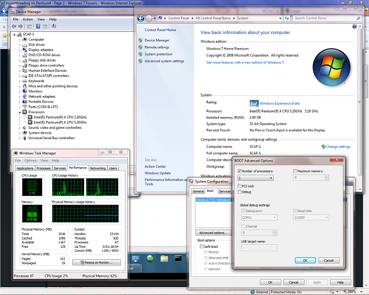

11 Dec 2009   #17
FTG
Well, I set HT to enabled in the bios, and re-installed. Still Windows shows 1 cpu graph. Then I went into bios and loaded all fields to defaults values, ( I don't know what else to try). And magically, Windows detects 2 logical cpus.
My System SpecsSystem Spec
11 Dec 2009   #18
Digerati
There you go. Funny thing about defaults - they tend to work. Thanks for the follow-up.

06 Mar 2010   #19
Slick1983
I'd like to revive this thread. My Pentium 4 3.2 is showing a paltry 1.7 performance rating after installing Windows 7. The BIOS is set to hyperthreading. The boot shows "2" processors. The Task Master shows two and I've rerun the tests. What am I missing?
07 Mar 2010   #20
logicearth
Windows 10 Pro (x64)
Quote   Quote: Originally Posted by Slick1983 View Post
What am I missing?
A modern processor. P4s are old, my Core 2 Duo at a measly 2 GHz outperforms a P4 clocked at 3+ GHz easily. Hyperthreading does not always equal better performance, btw.
