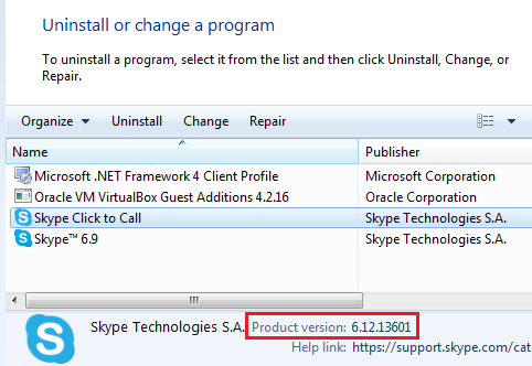

I did see that you had re-installed them... I just wanted to make sure that Skype did not barf after the latest OS/IE update/patch. Skype seems fine - so much for that theory.
All that I can suggest at this point is more types of scans for infections like I mentioned earlier.
