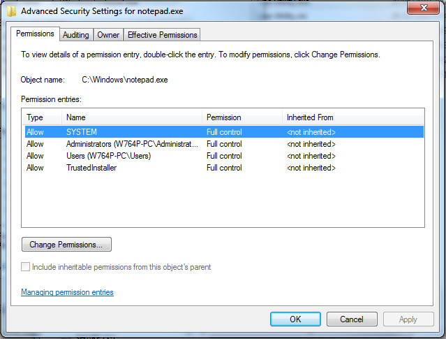

    How do you elevate Notepad permissions on a permanent basis without disabling UAC?

    I've elevated Notepad permissions FREE Great Programs for Windows 7-2011-03-21_155608.jpg but when I use Filenote... in "program files" I am still required to navigate to the relevant folder.
    FileNotes Windows Tagger does not have this problem and seems to be the better choice.

  9. Posts : 2,039
    Several, including Windows 7 x64 Ultimate
       #1509
    Hmmm...it works for me with elevated permissions on another machine.
    Whatever, try the file I just uploaded first. Much more comfortable and less dangerous.
    If you don't like it you can still use the other one.
    Regards...Mike Connor
