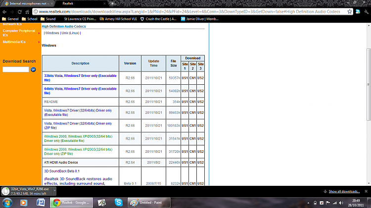

Is this the one?

Yes, go ahead and click on the US1 on the right in the very first row (starting with 32bit...)

Cheers, got about another 15 mins for it to finish downloading
