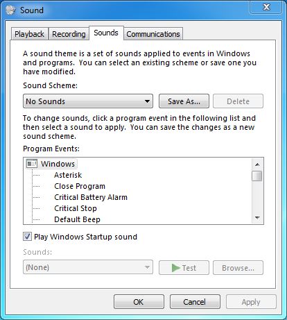

Malwarebytes does not cause any extraneous sounds. I have Malwarebytes installed (and running) in my Recording studio PC. When I record, I disable the internet but do not touch Malwarebytes and it does not cause any sounds or interfere with recording.
What do you have listed under Sound in the Device Manager? You should have your specific sound module (e.g. RealTek, IDT, etc) and possibly Intel HD Audio (for HDMI sound). If you have something else, such as "HD Audio Codec" that MAY be what is causing it.
This is what my Sound panel looks like, I can't have any system sounds when recording.

Thanks for the reply - I only mentioned MB as it was something someone else had suggested had stopped the sounds for them on a different forum. Uninstalling didn't help me. My sound panel looks exactly the same as yours. I am attaching my Device Manager and Sound snips. The strange thing is that today I am not getting the sounds. Yet all I have done since posting my problem (which had annoyed me for two days) is a standard Win 7 backup to an external hard drive. I didn't even reboot as I left the backup running overnight! Prior to posting I used CCleaner, Malwarebytes and Advanced System Care Pro and did a full virus scan and rebooted. The sounds continued. And now they have gone .... will I ever really understand computers? Will they return?
