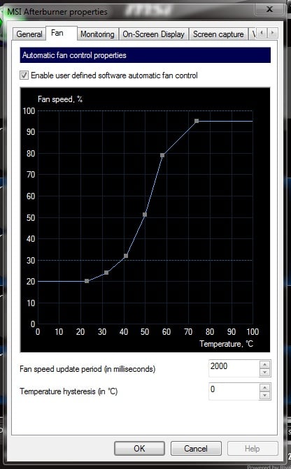

    In the case that you want to avoid the life-span shortenning of the gpu, you should install the utility called Afterburner and then use a custom fan speed control.
    ( this is a multifunctional utility for nvidia cards, it is mainly used for overclocking )
    Once you installed it, open afterburner and click on settings.
    Now go to the Fan tab and tick the box saying 'Enable user defined....'. Now you can manually determine the fan speed for the temperature value.
    Here are my settings as a reference. I recommend you to set the fan to around 40% for your idle temps, and let it spin up to 70-90% under full load which is the 70-80°C region in your case (some might say that they wouldn't spin the fan that much, and this is definetely more than what the card would spin it in auto mode)
    Upgrade from Windows Xp to Windows 7, Lag spikes, high Cpu Usage-dsadsafasdfasdf.jpg
    When you have done this, play some games and then measure the temperatures again please, so we will see how much it might have improoved.
