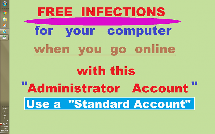

    He only has this one acct on here. After I get it cleaned up, I'll create a Standard User Acct for him. Then make his desktop on Admin Acct so hideous he'll stay away from it.

    What does this mean?? --> "Then make his desktop on Admin Acct so hideous he'll stay away from it"
  5. Posts : 75
    Windows 7 Pro 64bit w/ Virtual XP Mode
    Thread Starter
       #35
    It's a friends computer. I don't know how many times I've created a Standard User for him. He gets confused & frustrated because his favorites disappear, so he deletes one.
    About 4 months ago I did the same thing for another friend for same reason.
    I attached a png of his new Adm Desktop.
    Thank you everybody for help.
